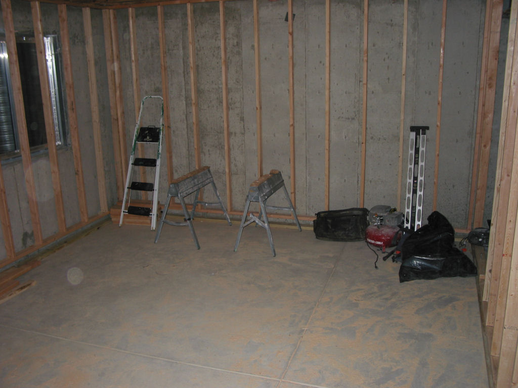

This started as a 21' x 21'x square with most of the ceiling being 9'. I put in a partition wall where the support beam was as this is where the lower ceiling began and it also worked out to pretty good dimensions for the sound. Now it's a little over 20' x 14' and about 8'4" high with a 5'6" entrance hall, which I'll use for storage as well.

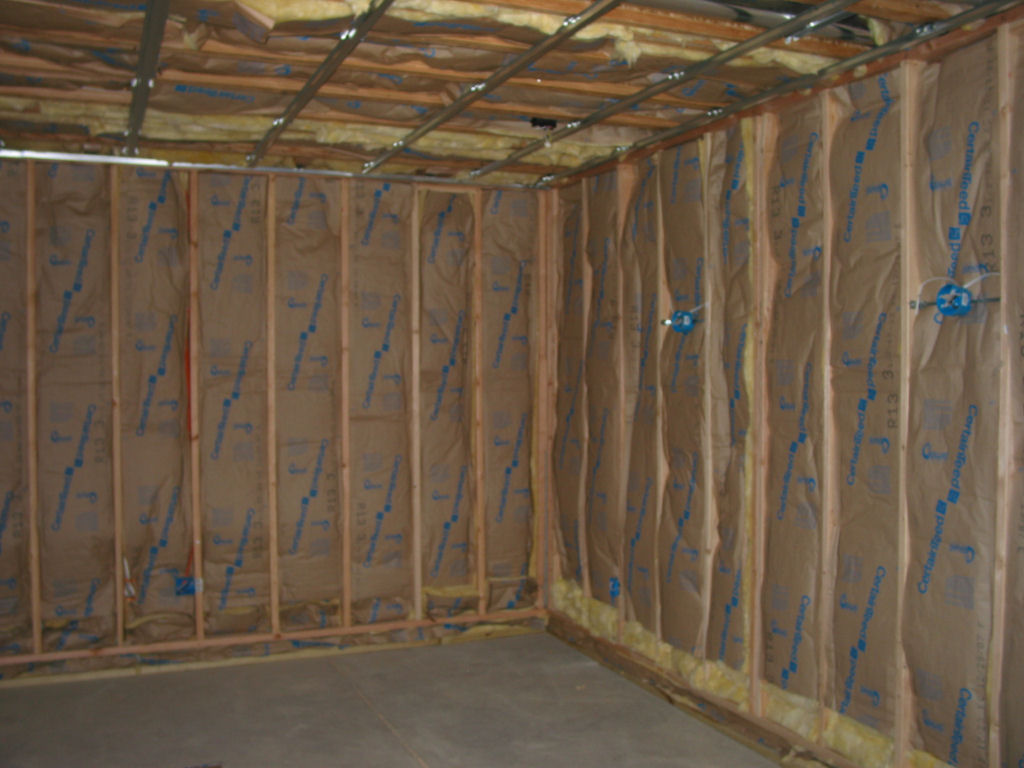

2 x 20A dedicated circuits. All other outlets on 15A circuit. Lights on separate 15A circuit. 20A outlets are 4 plex. Also pulled 2 sets of phone, ethernet and 2 RG-6 cables, so I have plenty of connectivity.

Realistically it will be shut most of the time. In the winter we rarely run the furnace, using a pellet stove as our main heat source in the living/dining area. I will put a space heater in the listening room and of course shut it off when I go down to listen. I had them use R-30 in the ceiling, R-13 in the walls and the sub floor is R-3.5. So once it's warm I'm hoping it will stay that way fairly easily.

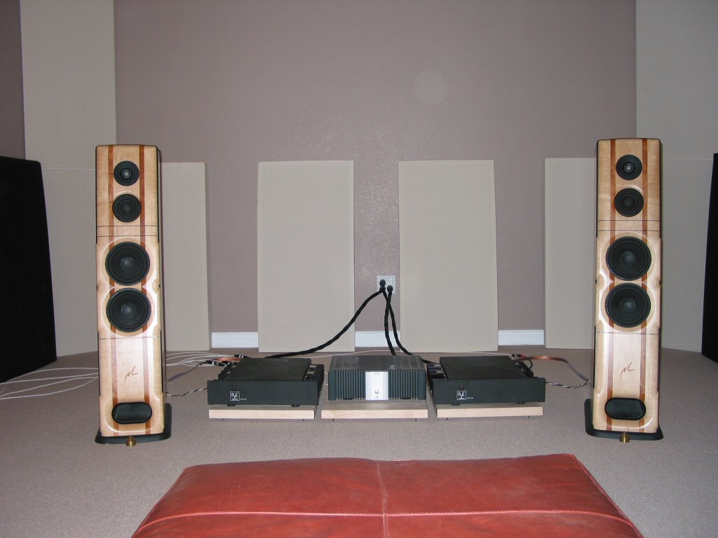

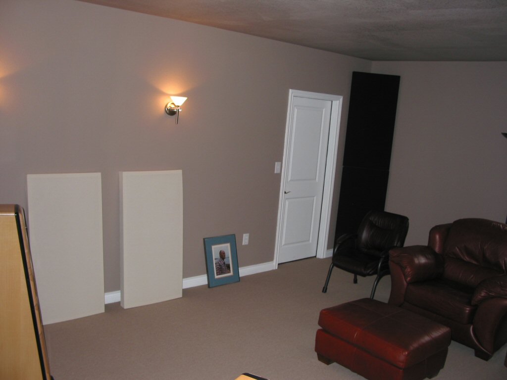

A few photos of the finished room. Of course the speakers and amps have moved a little since I snapped the photos.. and will likely continue to move until I'm happy. It's getting close but not quite there yet. At least it's listenable now. :)
It is very quiet in here.  8)
I still need to get the acoustic panels off the floor though I did hang two at the first reflection points a little while ago.
The one thing about having the luxury about putting the speakers anywhere I want is the choices are nearly endless... not that I'm complaining much.
Mike
