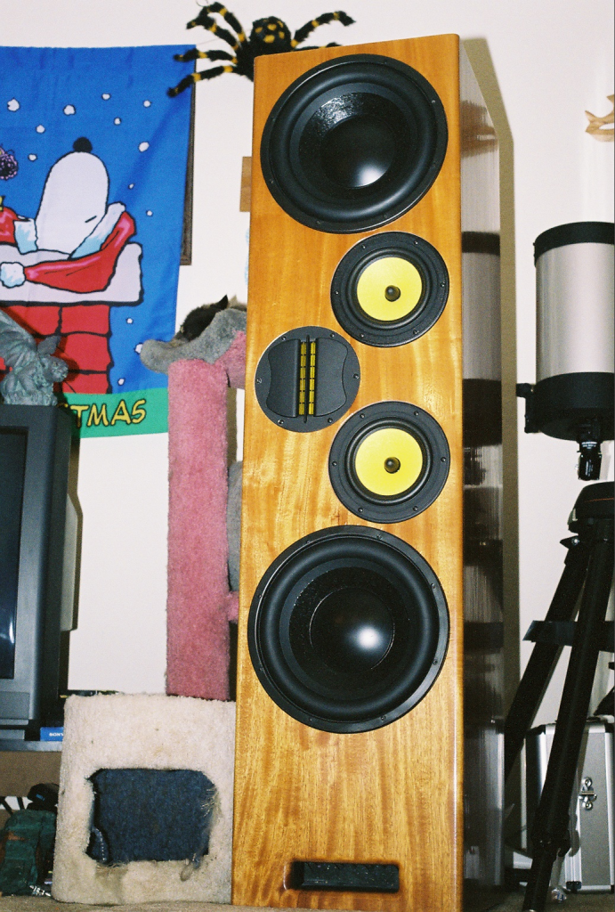

Ok so I sold my speakers I had before and have started on some new ones. I purchased a receiver to use as a Pre/Pro its a Sony STR-DA3300ES. This is a temporary processor until Emotiva releases their new stuff. I also purchased an Emotiva XPA-3 amplifier. Let me tell you guys if your looking for a cheap yet amazing product go with Emotiva this amp is a beast, absolute beast. It weights about 70lbs and is huge and its only a 3 channel. The 5 channel version weights something like 85lbs. Anyways I've also started on new speakers. I'll post a few pictures of the cabinets I have designed with the help of a friend for the mains. The center and surrounds will probably be boring boxes though.
A friend of mine is actually building a kit out of these but he's sharing the info with me. His cabinets are not the same as mine though. Also here is the data for the center channel and surrounds.
There are also going to be 2 15" subs in the works more then likely. So yes a lot has changed :) Working on redoing my DAC too and eventually going to get a 2 channel or a 5 channel XPA series amp if I do 5 channel then my front 3 speakers will be Bi-Amped.

By the way the drivers used in the speakers are the Tangband W4-1337SA mids, Dayton RS180-s Woofers, and Vifa XT25 Double magnet for the tweeters. This is an MTMWWWW configuration even the center is. Should be an amazing design :)

Dougie085,Apparently I can't type,the double magnet XT25 does look more desirable than the single magnet version,it is a closer match to the midranges in efficiency and the increased BL might give you a cleaner sound than the single magnet version. What crossover points will you have and what does system F3 look like it will be. Be sure to let us know how the finished speakers sound.
Scotty
Dougie085
F3 should be quite low I should have about 75L after bracing and driver displacement with 4 RS180's so I should be at an F3 somewhere in the mid to low 30's I believe. We just switched the drivers we were going to use because we were having a hard time getting a large qty of HiVi D6.8's in a timely manor. So I have yet to model the RS180's. Crossover points I can't remember exactly the tweeter will be something like 1.5-2khz though. We talked about it but I just can't remember now lol. He does all the crossover work as I'm an a novice at best when it comes to crossover design.
