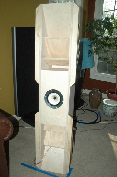

How thick is your BB?  What are the overall dimensions of the speaker, and what kind of finish do you have on the speaker?  Unfinished BB that's too thin for large unsupported areas can sound a bit weird.
And really, a 5 incher that's beaming?  Something doesn't sound quite right there -- is there a phase plug?
-- Jim
Re: "MooseStyle BVR" with Feastrex D5nf driver
« Reply #31 on: March 25, 2008, 04:36:10 PM »
Thanks guys.  Carl, my tools are your tools. Just sign this liability release form....
Jim, howdy partner! BB is 18mm, aka .69". Speaker is 58" tall, 10" wide, about 14" deep? Going from memory.  I don;t have any finish on there yet, which I am starting to gather is not good. Dave recommends a couple coats of varnish or something to cover it up. I love the look of raw wood, but I think that won't fly this time. I was thinking about painting it with latex paint. That will damp even better than varnish, but it is vinyl though. Does that piss off the Audio Goddess of Purity? I was thinking of painting same color as my fireplace - dark green.. Ahhhhh.... that's niiiice.....  8)
I did put some extension clamps across the horn mouths, that helped.
It is a 4" driver, with large wizzer and wooden phase plug. This speaker goes right up to 20k, so it should beam that high at 4" wide.  The beam is very high freq. Ducking out of the way is more pleasant for me, leaving the 12-15k stuff where the music is.

Thanks Mike. It took a little while to build them. Here are some shots of the interior plumbing, it is rather ornate, designed to minimize resonance in the middle box so it won't get amplified in the horns. Notice the driver mounting, it is held in place with a thread rod coming in from the rear. This locks the rear of the driver motor hard against the internal bracing and lets the driver bezel float free of the front baffle, except for a soft rubber or cork gasket. But it all has to be fit and tweaked. It is like a 911 GT2 race car, it rolls out of Porsche factory finished, but not even close to ready to race yet.
« Reply #36 on: April 29, 2008, 03:57:52 PM »
More to report...
The designer Dave Dlugos from Planet10 added bracing to cure the resonance we got on the first try. A couple panels went into each horn, and some external slats on the outsides of each horn, perpendicular to the internal braces.  A spine of bracing was also applied to the rear panels.
Altogether the speaker is greatly improved. There is still some boxyness and woodyness, and tapping the wood still has a little resonance, but it is listenable now, at least for me. I have a high tolerance for audio pain when the rest of the presentation is this good.
I plan to add stuffing to the inner chamber tonight which should further improve things by damping down the middle and upper frequencies and prevent them from being amplified by the horn. I will also paint them with a couple thick latex coats to damp the wood a little more. But of course I had to listen first, so I could learn what stuffing does - besides I just couldn't wait any longer. It feels good to check this project  off the 'to do' list. It has been a long time coming.
But I do intend to build it all over again a couple more times using different materials which should require significantly less resonance control, and so they should build much faster. I have high hopes for those. The baltic birch is just not my cup of tea dispite its long history as material of choice for single driver designs.
These things have incredible tone, dynamics, clarity, detail beyond your wildest imagination. Imaging is surreal. I can't listen with my eyes closed, the imaging is too distracting. I keep feeling there is someone really there and my subconscious reflex opens my eyes to see. With further improvement in the resonance and type of wood I think it will be something very special. The drivers are the star of course, they really deserve the finest cabinet possible, and reward richly for the effort.
So yes, if you come over on May 17th you will be able to hear them this time. Maybe even further revisions... 8)

Thanks Mike!  I listened again tonight (2nd impresion) and it is not as bad as I may have let on first post. It's easy to listen through the remaining wood, but it would be nice to clear it out altogether. Or if wood must remain, make it pine or something that sounds good naturally.
I have not tried any of that stuff, but about every 4 months Carl is recommending I try black hole for something or other. John uses plasticlay in TTs, but I never thought about it in a speaker box. Good idea! This speaker's designer, Dave Dlugos believes that damping birch only makes the resonance lower in frequency which sounds worse. He tends to lean toward tensioning and bracing it to raise the resonant frequencies out of the passband. I like the idea, but in practice it is more difficult to build, but the results seem to be worth it. I am really enjoying this speaker.
I hope what is happening is the midrange freqs inside the speaker are being woodied up inside the box and more in the horn while amplified in the horn. Some wool inside will damp mids coming out of the tuned port, and might solve it.
